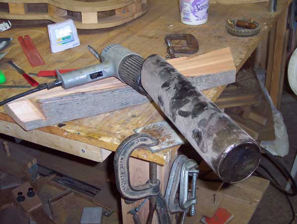

Here is my homeade one. I use a heat gun. I only use it for the sharp cutaways.

I would highly recomend using a Heat Gun instead of a torch if you have one. Orriginally I used a torh and then tried the heat gun. Heat gun is safer and gives great control over the temp. I also found a problem with the torch blowing out sometimes.
PostPosted: Wed Nov 22, 2006 1:42 pm
ditto on what Richard said above, my heat gun has a temp control, much safer than an open flame. I used a threaded piece of 2" oil field steel tubing with a cap.

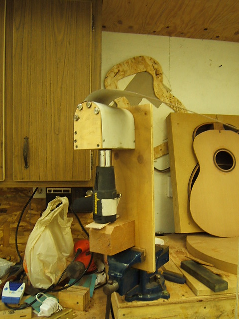

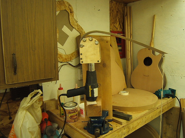

I use a heat gun for my florentine cutaway bending jig and it works slick.
I also use it in a piece of 2" ss pipe I have for touch ups.
